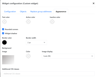

1) there is something of strange in setting widget, if I select round border 2 px black (example) on the 'Edit plan' I can't see this set but on 'Tile view' I can see all in the right way. Is It correct?

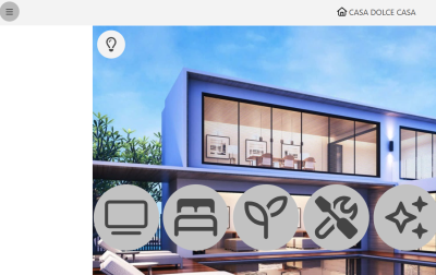

2) In old Mosaic and visualization too, there was 'additional icon' or 'Value (icon)' that was very usefull now I can't find. Have they been eliminated? it's a shame because it was useful for status object that could have several value (ex Clima mode)

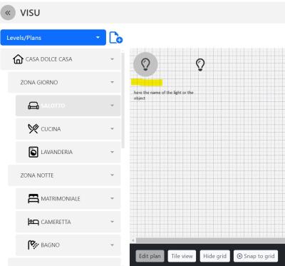

3) It is neccessary that the integrator can have the possibility in 'edit plan' to show the name of the object (switch it is not possible)

1. For now border/background applies only to Tile view. We are considering adding an option to apply these settings to Plan view too.
2. Compact mode > Additional values / icons is probably what you are looking for.
3. Please explain in more detail.

Hi admin and thanks for feedback
1. OK
2. Please see photo "point 2" to understand what I'm meaning.
3. See photo "point 3"

2. You can use "Numeric value display (read-only)" for that:
To point 3, what if there is more than one object which usually is on a widget?
(22.10.2024, 06:28)admin Wrote: 2. You can use "Numeric value display (read-only)" for that:
Thanks, I missed this.
BR Cristian
(22.10.2024, 07:49)Daniel Wrote: To point 3, what if there is more than one object which usually is on a widget?
Hi Daniel,
you are right I've not valueted this solution. Thanks for the trick.
Best regards Cristian

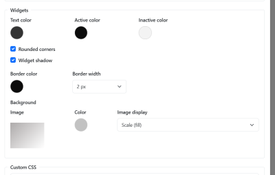

I don't have a mind if this behavior has already been reported.
swipped from tile to plan widget lost the apparence.
In the video there's an example.
Plan widgets has background inside the shape in tile it goes out.
.zip   Registrazione dello schermo 2024-11-01 104821.zip (Size: 1.23 MB / Downloads: 4)
Where did you apply the appearance? In the widget or global?
(01.11.2024, 10:14)Daniel Wrote: Where did you apply the appearance? In the widget or global?
hi Daniel,
Global. I tried in widget too. But same result.
This works for me, what browser and OS do you use? Send me your widget background.
(01.11.2024, 10:43)Daniel Wrote: This works for me, what browser and OS do you use? Send me your widget background.
Os Chrome, in the attached file the background.
.svg   bg_gray_gradient.svg (Size: 733 bytes / Downloads: 4)

Go to custom widget menu, edit your widget and remove background there. This is above global, I know confusing and we need to do something about this.

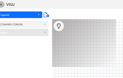

I need an information because I can't understand. I tested Layout, I create one with another background (different of the one in home page) I added the objects. Result: In the home page I see the objects but not the background layer. What m I missing?
#19
Share your visu app backup.
