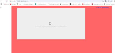

What is the URL are you trying to show?
Posts: 8534
Threads: 47
486
Most websites don't allow to be included via iframe. This is a built-in browser security feature which cannot be disabled.
Posts: 41
Threads: 9
Joined: Jan 2016
The website is dakboard.com
