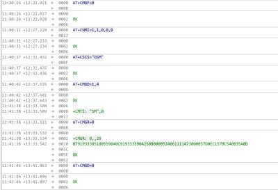

This is the serial communication LM<-->TRB142 from LM reboot to SMS receive,
It seems correct to me and I don't understand why incoming SMS are not processed.
HTH

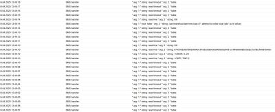

And log what is the result of parsing SMS PDU:
res, sms = pcall(AT.parsepdu, sms)
log(res, sms)
Log screenshot:
