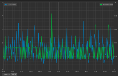

If this graph is correct then your CPU is very high.

Reboots lately are more and more frequent, and it is not a temperature problem because the CED is air-conditioned.
After trying to optimize the execution of the multiple scripts, I just have to think that the number of users who connect at the same time also has an influence.
Is there no way to limit user access at the same time, or at least to warn you that you are reaching the limit?
I see from the "system load" that the nginx process is often on top of cpu/memory consumption.

If one LM cannot handle it then the only way is to divide project into two.
