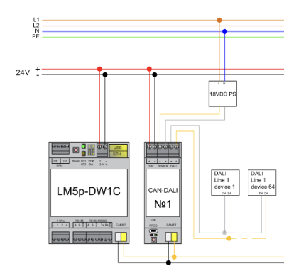

I'm considering using your CANX DALI Gateway and have a question regarding the power supply.
https://openrb.com/canx-dali-gateway/
I'm looking for an 18VDC power supply, not DALI power supply. I've only been able to find these two options: Do you have any recommendations for other 18VDC power supplies that are commonly used with the gateway?
You don't need a high current power supply - by DALI standard maximum is 0.25A.
Meanwell HDR-15-15 can be used. Nominally it's 15V but can be adjusted up to 18V.
