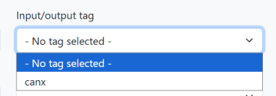

You need to assign this tag to objects first.
Posts: 5435
Threads: 30
243
Go to LogicMachine object tab and click on it and add TAG. You can also use filter and Mass edit to do many at once.
