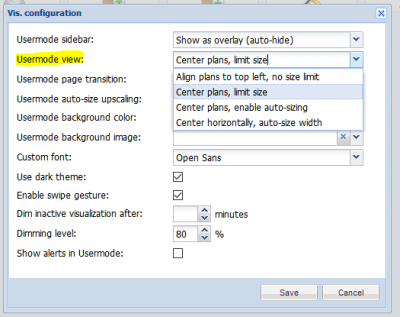

It looks like VLC plugin does not work when auto-scale is enabled. This is browser issue and the only way to solve it is to disable auto-scaling (see attached screenshot).

Sorry, with the disabled auto-scaling the problem is the same.

Can you show which settings are you using now?
Posts: 152
Threads: 22
Now it is OK, it was necessary to desable "Usermode auto-size upscaling"....Thank you!
