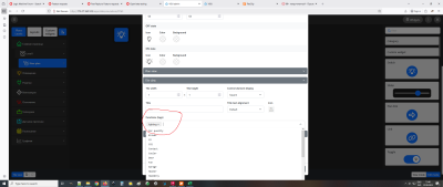

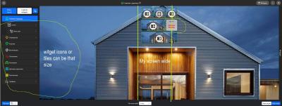

3. How can I do wide of icon/widget to max to screen width (I changed icons width - but not work) - see picture in attach
4. Plan view link - http://IP/apps/data/visu/, what is tile view link?
5. For widget functions/tags would be good to add custom names additionally to already added list. Why - just for usage any other language. (another pic in attach)

RE: Feature requests - admin - 07.08.2025
1. Use 2025.07 beta firmware. It already includes the latest Visu package.
2. Widgets in Tile view are placed horizontally first (same as in Mosaic). You can adjust the Tile view width in admin mode to see how it will look on a different screen. Phones usually fit 3 tiles.
3. Tile view width/height controls the widget size.
4. It switches automatically based on the screen width. See General settings > View mode.
5. This will be implemented later.

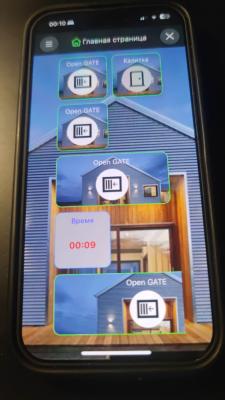

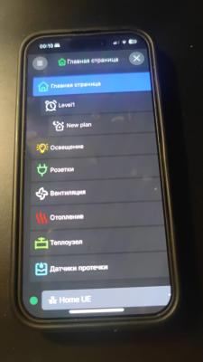

trying create for customer visu these weekends. Used Tile view, now I decided use just mobile phone for remote control over cloud. Still many things I think should be improved:
1. I use Iphone 16. Screen resolution  2556‑by‑1179-pixel. Only 2 tiles possible to see at screen. (tile 16x16 min size used). So here what I needed:
a. possibility to set screen size in pixels. Of course super idea automatic adaptation to any screen size, but if we know size, we can use widget size to full width of screen, in my case I can see just 2 tiles and some gaps from both sides, not possible to use full wide of screen. At pic1 is possible to see visu screen with 16x16 tiles 1, 2 and 3 in a row, at pic2 is my phone screen where we can see that only 2 tiles seen..
b. possibility to use much much smaller tiles and visu - would be good if element size can be like in the menu at pic1 (left side). Now modern app can show aprox 30 diff elements on screen - graphs, info etc.. Now tiles too big.

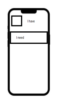

c. I used not all widgets, but what i need for switch widget - would be good for title also change color and size. Also good if possible to locate title not just above and change place of text (left/right/default/center) but locate at the left side of the icon in widget 2x1 as example (see pic);

RE: Feature requests - Daniel - 11.08.2025
How to make custom widgets: https://app.screencast.com/X5hnvsip9yRdL
You must have some scaling enabled as we checked loads of mobiles and 3 tiles always fit.

RE: Feature requests - AlexLV - 12.08.2025
Daniel, thank you, scalling help me, returned to standard settings I see 3 tiles in a row.
