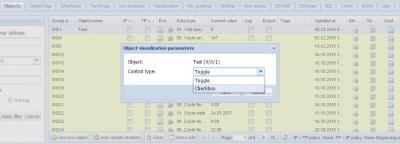

RE: Object behaviour - FatMax - 15.12.2015 In the smartphone view, I only have a toggle switch to choose from to initiate the garage door. Am I missing a simple button for smart phone usage..? It might be confusing for people to see a switch that looks like its off or on... RE: Object behaviour - edgars - 15.12.2015 In Objects tab --> Visualization parameters you can choose either to show the button as Check-box or as Toggle. I attach screenshot. Hope this helps! RE: Object behaviour - AdriSaliai - 28.12.2015 Hello i have a problem . In visualization i install a IP camera but i have not streaming live it only show the first picture of the place and not streaming . Can someone help me ???
