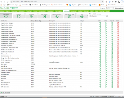

RE: Email sending do not work - Tue - 20.08.2020
(20.08.2020, 09:42)admin Wrote: Left bottom corner of the main UI (Version: 20200720 or similar)
Look at attached
Now attached :-)
