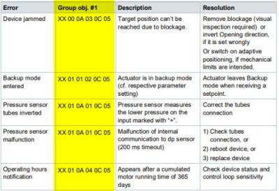

6byte - DPT - Fahd - 16.08.2022 Hi gyus, How could I read a 6byte alarm code from the knx bus (Please , see attached ) RE: 6byte - DPT - admin - 16.08.2022 You can use "14 byte ASCII string" data type. In event script you can check the event.datahex variable contents to determine what kind of alarm it is. RE: 6byte - DPT - Fahd - 16.08.2022 (16.08.2022, 09:34)admin Wrote: You can use "14 byte ASCII string" data type. In event script you can check the event.datahex variable contents to determine what kind of alarm it is. Please, Could I just get an example of the first alarm code ? RE: 6byte - DPT - admin - 16.08.2022 Code: alarm = event.datahex:sub(3, 12)
if alarm == '000A030C05' then
log('jammed')
elseif alarm == '0101020C05' then
log('backup')
endRE: 6byte - DPT - Fahd - 16.08.2022 (16.08.2022, 09:44)admin Wrote:Thanks |
