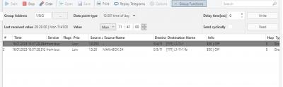

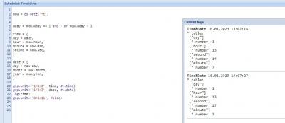

Date / Time Object - tom77 - 10.01.2023 Hi, unfortunately it does not work for me that I assign a date / time object in the visualization a new value.The Date / Time Picker opens but the selected value is not applied. Does anyone have an idea how I can do this (firmware 20221205) Best regards, Thomas RE: Date / Time Object - Daniel - 11.01.2023 Can you make a video and show how you do it? RE: Date / Time Object - tom77 - 11.01.2023 Hello Daniel, attached is the screenrecord,unfortunately no event seems to be triggered either tried with value = event.getvalue() log(value) to display this but nothing happens RE: Date / Time Object - Daniel - 11.01.2023 Send me your backup to PM. It works fine for me. You will need to upload it somewhere and send me a link like https://wetransfer.com/ RE: Date / Time Object - admin - 11.01.2023 Can you control any other objects? Maybe the websocket connection is blocked. Check browser console (F12) for any errors. RE: Date / Time Object - tom77 - 11.01.2023 Yes the problem occurs only for date and time ok I have tested it on another LM there it works ... I reset and see if it works is eh only my test server .... sorry had not thought to test the times where else thanks a lot RE: Date / Time Object - spoty2008 - 16.01.2023 Hi all. I have the same problem. Only the time and date are not written to the bus. The latest firmware. There is a connection to the bus. Other objects are being written. RE: Date / Time Object - Daniel - 16.01.2023 Please explain the steps how do you perform the write. RE: Date / Time Object - spoty2008 - 16.01.2023 (16.01.2023, 09:14)Daniel Wrote: Please explain the steps how do you perform the write.now = os.date('*t') wday = now.wday == 1 and 7 or now.wday - 1 time = { day = wday, hour = now.hour, minute = now.min, second = now.sec, } date = { day = now.day, month = now.month, year = now.year, } grp.write('1/0/6', time, dt.time) -- time value grp.write('1/0/7', date, dt.date) -- date value log(time) grp.write('0/4/11', false) ------------ This is a standard script. It works on other logic machines. The problem is only on the current one. The last line is the address to check that there is a connection and the values are being sent (the values are being sent). I tried deleting objects in the logic engine and recreating them from ets. Tried to create objects completely manually - nothing helps. (16.01.2023, 09:19)spoty2008 Wrote:(16.01.2023, 09:14)Daniel Wrote: Please explain the steps how do you perform the write.now = os.date('*t') The values of the object in the logic machine change, but nothing is written to the bus. I watch group monitoring from ets. RE: Date / Time Object - admin - 16.01.2023 1/0/7 has incorrect data type, it should be 11. 3 byte date. The date value is written, but it's interpreted as 16:01:23 instead of 16.01.2023. RE: Date / Time Object - spoty2008 - 16.01.2023 (16.01.2023, 09:32)admin Wrote: 1/0/7 has incorrect data type, it should be 11. 3 byte date. The date value is written, but it's interpreted as 16:01:23 instead of 16.01.2023. This I experimented with other objects. Initially, the addresses were with the correct data types. 1/0/2 and 1/0/3 RE: Date / Time Object - Daniel - 16.01.2023 I tried this and all is working fine for me. What script do you use for this, Any errors? RE: Date / Time Object - spoty2008 - 16.01.2023 (16.01.2023, 09:57)Daniel Wrote: I tried this and all is working fine for me. What script do you use for this, Any errors? The whole problem is just that. On others (I tried on 3 different logic machines in different places) with the same firmware and older ones - everything works well. The script that I use came above the post. In the same script, I turn off the lighting at 0/4/11 and the shutdown works. No errors. RE: Date / Time Object - Daniel - 16.01.2023 Send me your backup to PM, we can't reproduce this. RE: Date / Time Object - spoty2008 - 16.01.2023 (16.01.2023, 10:41)Daniel Wrote: Send me your backup to PM, we can't reproduce this. i send to you RE: Date / Time Object - Daniel - 16.01.2023 It is all working fine. Maybe it is some ETS issue? Do you have another LM? You could connect it via TP and see if objects are updated. RE: Date / Time Object - spoty2008 - 16.01.2023 (16.01.2023, 12:28)Daniel Wrote: It is all working fine. Maybe it is some ETS issue? Do you have another LM? You could connect it via TP and see if objects are updated. I have several remote objects. I checked on other logic machines. The same script (usually I use it when there is nowhere to take time, except for the Internet), there is no such problem anywhere. After trying all possible options, I started looking on the forum for a similar problem and was surprised when I found it right away, like tom77. What else can you recommend? Downgrade is not possible. There is nothing on the LM, except for 1 script. RE: Date / Time Object - Daniel - 16.01.2023 I checked your backup and it works fine on latest fw. The issue must be elsewhere but I have no idea where. RE: Date / Time Object - spoty2008 - 19.01.2023 (16.01.2023, 14:54)Daniel Wrote: I checked your backup and it works fine on latest fw. The issue must be elsewhere but I have no idea where. Hi. The problem was communication. |
