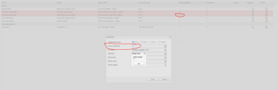

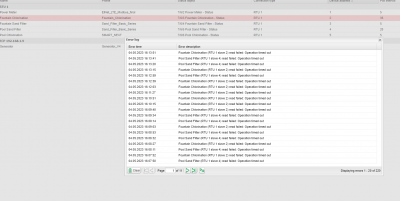

Modbus device disconnected but can be read from read test - khalil - 17.04.2023 Hello Dear, I have a disconnected Modbus device, but when I try to read from Read Test its give a value. the error log gives: read failed: operation time out. please see attached image RE: Modbus device disconnected but can be read from read test - Daniel - 17.04.2023 Try increasing timeout, should help RE: Modbus device disconnected but can be read from read test - khalil - 18.04.2023 (17.04.2023, 11:35)Daniel Wrote: Try increasing timeout, should help Hello @ Daniel unfortunately it didn't help. could it be a grounding/wiring issue! while all the Modbus devices shown in the previous attached image are in the same loop! RE: Modbus device disconnected but can be read from read test - Daniel - 18.04.2023 Correct wiring is always important as this can create noise. Increase the pool interval for all devices, start from 60sec. RE: Modbus device disconnected but can be read from read test - khalil - 04.05.2023 Hello dears If I have a profile but some addresses are not connected, then does these non mapped registers polled? RE: Modbus device disconnected but can be read from read test - admin - 04.05.2023 Entries without mapped objects are not polled. RE: Modbus device disconnected but can be read from read test - khalil - 04.05.2023 (04.05.2023, 13:09)admin Wrote: Entries without mapped objects are not polled. thank you admin another question how the SL,LM poll mapped registers one by one or as a group. if it pulled one by one, is it possible to make a group poll to decrease the traffic? please advice regarding these errors, two Modbus RTU devices keep connecting and disconnecting RE: Modbus device disconnected but can be read from read test - admin - 04.05.2023 Profile can be modified to use a single block read by setting read_count / read_offset parameters. See these threads: https://forum.logicmachine.net/showthread.php?tid=4687&pid=30319#pid30319 https://forum.logicmachine.net/showthread.php?tid=2995&pid=19268#pid19268 As for connection issues you might need to add read_delay to the profile. RE: Modbus device disconnected but can be read from read test - khalil - 04.05.2023 Many thanks admin Will try and see Edit: I added the read_delay to one profile and the device connection issue solved. Should I add the read_delay to all devices, or only to those showing connection error? Also, If you could describe how the read_delay work, and how it solve the connection issue? RE: Modbus device disconnected but can be read from read test - Daniel - 09.05.2023 LM is just waiting before sending new read request. Some slaves do struggle to answer quick requests. If you have same devices then I would add this to all of them. RE: Modbus device disconnected but can be read from read test - khalil - 11.05.2023 (09.05.2023, 09:14)Daniel Wrote: LM is just waiting before sending new read request. Some slaves do struggle to answer quick requests. If you have same devices then I would add this to all of them. Thank you Daniel |
