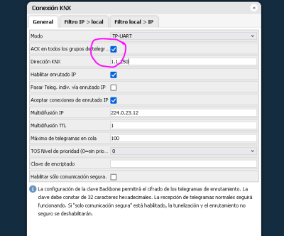

For incoming telegrams to LM you can enable "ACK all group telegrams" in KNX settings.
For outgoing telegrams from LM you need an external device on the bus to ACK the telegrams. No other solution.

(26.04.2024, 10:30)admin Wrote: The only solution is to enable "ACK all group telegrams" in KNX settings.
Hi admin,
It was already check, this feature is working but in the other direction, if from knx someone send a message, the LM send an ACS, that works! , but I mean the otherwise, like if from the  VISU I could update the variable instead of writing the variable since I dont needs this variables in the bus.
