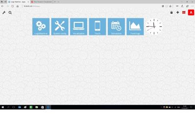

Mosaic 2.0 20170602 - GenaV - 31.05.2017 Hello! Installation of Mosaic 2.0 20170602 - result is bad, completely disappeared Mosaic buttons. Uninstallation, installation again - result is same. RE: Mosaic 2.0 20170602 - rocfusion - 01.06.2017 Yep, same thing here too. RE: Mosaic 2.0 20170602 - GenaV - 01.06.2017 Can you fix Mosaic 2.0 20170602 problem ASAP or return back previous version? RE: Mosaic 2.0 20170602 - admin - 01.06.2017 This is an issue caused by Apps server upgrade. You need to install this fix through Utilities -> Install updates, then reinstall Mosaic and it will work: https://dl.openrb.com/lmup/2017.05.29-apps-install.lmup You can also install RC3 or later where this bug is fixed. RE: Mosaic 2.0 20170602 - rocfusion - 01.06.2017 it works, thank you RE: Mosaic 2.0 20170602 - GenaV - 01.06.2017 Thank you, works! RE: Mosaic 2.0 20170602 - Rhis - 02.06.2017 (01.06.2017, 06:04)admin Wrote: This is an issue caused by Apps server upgrade. You need to install this fix through Utilities -> Install updates, then reinstall Mosaic and it will work: After fix here is still error in error log --- mosaic20 02.06.2017 17:44:31 cannot open /data/apps/store/data/mosaic20/lua/mqtt_library.lua: No such file or directory RE: Mosaic 2.0 20170602 - buuuudzik - 08.06.2017 I have also the same RE: Mosaic 2.0 20170602 - jetsetter - 09.06.2017 Same here too... RE: Mosaic 2.0 20170602 - morak - 09.06.2017 (02.06.2017, 15:24)Rhis Wrote:You have install the patch, then uninstall Mosaic and then instal Mosaic again.(01.06.2017, 06:04)admin Wrote: This is an issue caused by Apps server upgrade. You need to install this fix through Utilities -> Install updates, then reinstall Mosaic and it will work: RE: Mosaic 2.0 20170602 - buuuudzik - 09.06.2017 When I tried update LM Load Balancer it stopped work the same as was with upgrade RC3
