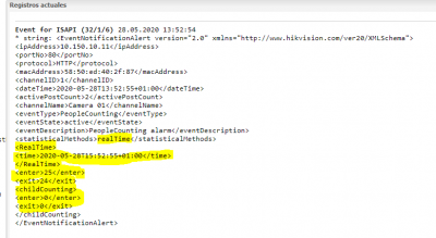

I rescue this thread to see if anyone can help me,
How can I find the values in the XML data that the string returns? specifically what I need are the ones marked in yellow in the attached screenshot. These records are only sent if: <statisticalMethods> realTime </statisticalMethods>
Thank you very much in advance !!

You need to parse the XML data to get values from it, you can use the build in LuaExpat lib for that.
See this post for a sample how to use the lpx parser:
http s://forum.logicmachine.net/showthrea...2#pid11472

(28.05.2020, 21:16) Erwin van der Zwart Wrote: Hi,
See this post for a sample how to use the lpx parser: http s://forum.logicmachine.net/showthrea...2#pid11472
Thank you very much Erwin, it's just what i needed.
