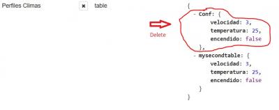

Hello Erwin, thanks for answering, with your help I have been able to progress to store and even obtain a part of the table (Conf) and pass it to a Group address without having to touch the other tables (mysecondtable). My question is if I can delete one of the subtables, without having to delete the parent table ´Perfiles Climas´ or the other child table mysecondtable. I have used this code and others, but modifying it, but it did not work for me and even in some it generates an error.
1234
Nombre_modo = grp.getvalue('32/1/21') datotabla=storage.get('Perfiles Climas') log (datotabla.Nombre_modo) storage.delete(datotabla[Nombre_modo])
I attach a photo of the only thing I want to delete.

What you can do is this:
1234
Nombre_modo = grp.getvalue('32/1/21') datotabla=storage.get('Perfiles Climas') datotabla[Nombre_modo] = nil -- this will delete the sub table storage.set('Perfiles Climas', datotabla)
