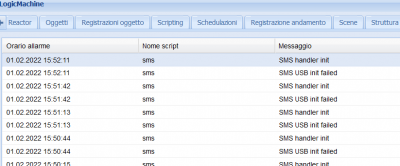

I asked for the 4g modem to be installed in the reactor, since a customer has only provided me with 4g sim, when the APN returns and the internet connects, I send the emails but I have an error in sending the SMS.
Does the SMS library also have to be modified in order to manage the new modem?
below the error reported in the offending lines

(31.01.2022, 15:30) admin Wrote: This script has nothing to do with the SMS sending via modem it simply sends message to the resident script. Post your full resident SMS script and a screenshot from System config > Status > System status > Serial ports.
resident sms

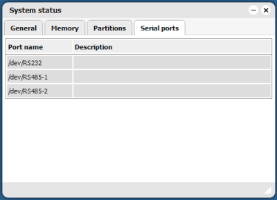

Posts: 8165
Threads: 43
473

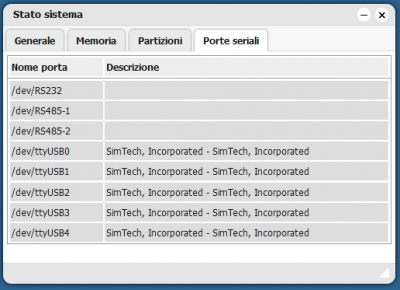

Replace ttyACM3 with ttyUSB2

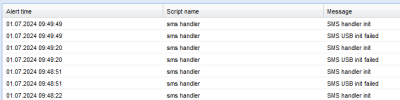

You have the same code in the resident script twice, this can lead to errors. You've also commented out all alerts so there's no way of knowing if the script is working or not.
Replace your resident script with this and post what you get in alerts:
1 2 3 4 5 6 7 8 9 10 11 12 13 14 15 16 17 18 19 20 21 22 23 24 25 26 27 28 29 30 31 32 33 34 35 36 37 38 39 40 41 42 43 44 45 46 47 48 49 50 51 52 53 54 55 56 57 58 59 60 61 62 63 64 65 66 67 68 69 70 71 72 73 74 75 76 77 78 79 80 81 82 83 84 85 86 87 88 89 90 91 92 93 94 95 96 97 98 99 100 101 102 103 104 105 106 107 108 109 110 111 112 113 114 115 116 117 118 119 120 121 122 123 124 125 126 127 128 129 130 131 132 133 134 135 136 137 138 139 140 141 142 143 144 145 146 147 148 149 150 151 152 153 154 155 156 157 158 159 160 161 162 163 164 165 166 167 168
if not numbers then
require (

problem to init
Posts: 8165
Threads: 43
473
Sorry, that was an old script. Replace ttyACM3 with ttyUSB2 and restart the script via disable/enable.
Posts: 343
Threads: 131
Joined: May 2020
(01.02.2022, 14:56) admin Wrote: Sorry, that was an old script. Replace ttyACM3 with ttyUSB2 and restart the script via disable/enable.
Same error , need som in init script ?
Posts: 8165
Threads: 43
473
Can you provide remote access to your LM?
Posts: 343
Threads: 131
Joined: May 2020
(02.02.2022, 09:13) admin Wrote: Can you provide remote access to your LM?
via zerotier is ok ?
Posts: 8165
Threads: 43
473
Yes, send your network ID, LM ZeroTier IP and admin password via PM.
Posts: 8165
Threads: 43
473
Check if it's working now. You had a space after the serial port name so it did not work:
Posts: 343
Threads: 131
Joined: May 2020
(02.02.2022, 09:53) admin Wrote: Check if it's working now. You had a space after the serial port name so it did not work:
tanks a lot
Posts: 343
Threads: 131
Joined: May 2020
Hello
For the problem of sending sms I solved with your help in 2 reactor out of 3, in the third with the same scripts, if I text the sms calling send it works, while if it is called from the script the alalrme event does not work, while the mails from the same script do
The alalrme event scripts I checked it are like in the reactor it works in, I'm getting lost and I don't know where.
I accept advice
Thank you
Posts: 8165
Threads: 43
473
Have you replaced the sendsms function as specified?
https://forum.logicmachine.net/showthrea...1#pid24831
Do you have anything in alerts and logs?
Posts: 343
Threads: 131
Joined: May 2020
(03.02.2022, 07:27) admin Wrote: Have you replaced the sendsms function as specified? https://forum.logicmachine.net/showthrea...1#pid24831
Do you have anything in alerts and logs?Hello
I found the problem, the phone number had a space at the end for which it was not valid, now I try how to remove the spaces before and after, both for the phone number and if I can also for the email address so as to no longer have the problem.
Thank you

We are having the same problem that Frank68 sending SMS.
The LM was working fine but from one day to the other it stop working. We tried changing the comport, factory reset the LM and even tried it on other LM with no result.
On Alert tab we keep getting SMS USB init failed.
Another thing I find strange is that the serial ports don't show on system status (view image).
Our firmware is Version : 20230612.
Thanks for your hel p,
Neves
