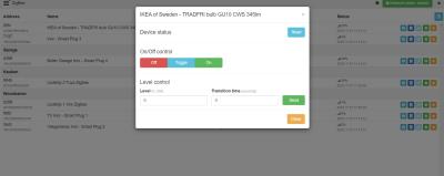

Is it possible to Add a profile for this Device, harder and softer does work, but it is not possible to adjust the collors, but you can do so on the lamp?
With Homey I can adjust the colors with RGB or color temperature.
IKEA of Sweden - TRADFRI bulb GU10 CWS 345lm - device information
Manufacturer: IKEA of Sweden
Model: TRADFRI bulb GU10 CWS 345lm
Firmware version: 1.0.021
Device type: Router
Power source: Mains
Receive when idle: Yes
Endpoint 1
Profile: 260
Input clusters
- Basic (0)
- Identify (3)
- Groups (4)
- Scenes (5)
- OnOff (6)
- LevelCtrl (8)
- LightingColorCtrl (768)
- HaDiagnostic (2821)
- LightLink (4096)
- 64636
Output clusters
- Ota (25)
Endpoint 242
Profile: 41440
Output clusters
- GreenPower (33)
Reported attributes
- level: 30
- onoff: true
Posts: 8774
502
Profile for TRADFRI bulb GU10 CWS 345lm will be added in the next app version.
