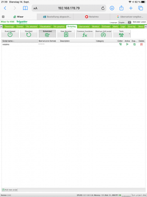

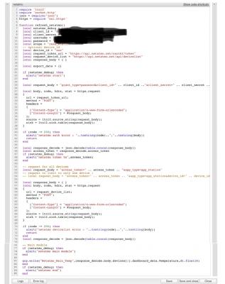

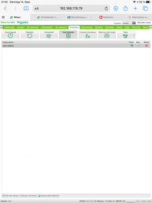

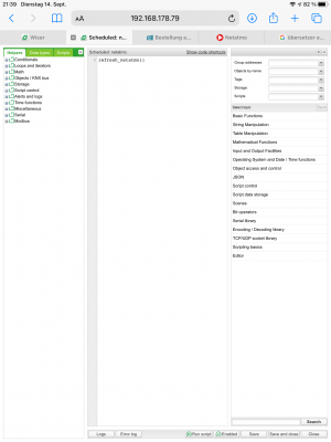

I implemented the script as described unfortunately no value is written. I implemented just one object to get it working and scale it afterwards, In the failure log the following message is shown:
„netatmo 14.09.2021 21:44:00
User script:1: attempt to call global 'refresh_netatmo' (a nil value)
stack traceback:
User script:1: in main chunk“

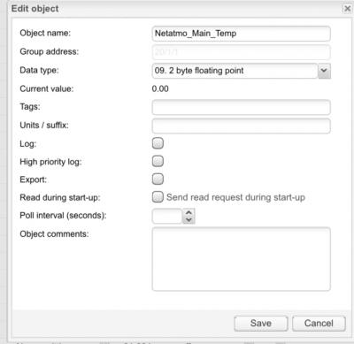

My configuration is attached, do you see any mistake and reason why it doesn’t work?
Many thanks for your help.
