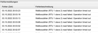

(03.10.2022, 07:54)Daniel Wrote: Try this:
{          "bus_datatype": "int64",       "address": 20480,       "type": "register",       "units": "kWh",       "value_multiplier": 0.01,       "name": "Active import",       "datatype": "uint64"     },
Try using profile generator if this is simpler.
https://forum.logicmachine.net/showthrea...8#pid19678
I´ve tested it but it doesnt work. Here are some pictures. I always get a "operation time out", but the read test works!
