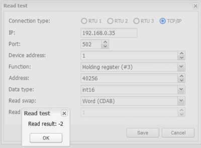

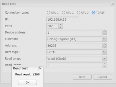

I'm trying to create a modbus profile, but I'm having some trouble with scale factor: "address_scale". Without this scale factor, profile is working, but we get wrong values due to "live" multipliersd.
Testing register and his scale factor with the tool "read test", they are working properly. But I do not get response with both together in the profile.
    Holding register: 40293,  uint6--> 2260
    Holding register: 40256 ,  int16--> -2
    Tension on MPTT1: 2260 * 10^-2= 22.6 V; that is correct
I attach my profile, that it is created with map register of post #17.
Any help will be welcome.
