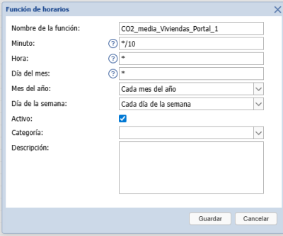

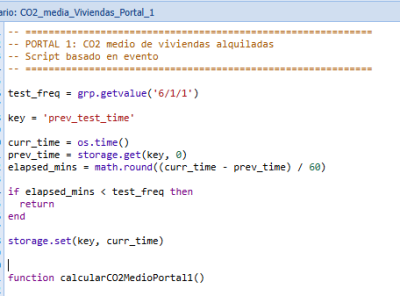

Good morning, a month ago you helped me with a script programmed to run according to the hourly value of a group address. I wanted to ask if, if we want a script to run according to a variable that has a value between 10 and 55 minutes (6/1/1), the following code and the image configuration would be correct. For example, if 6/1/1 were to have a value of 30 minutes, would this configuration cause the script to run only every 30 minutes?
