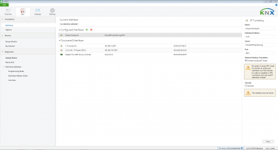

Hi yes I have. How can I upload pictures or to send you by email?
#29
(27.08.2018, 11:15)XSPA2474KW Wrote: Hi yes I have. How can I upload pictures or to send you by email?
Press replay and add New Attachment Wink

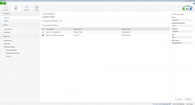

Yes when I use LAN the ETS detects automatically the HomeLynk and I can download application and address

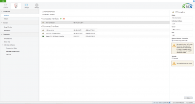

No i mean your WAN address from your ISP, now you use DynDNS in the connection but does it work when you enter the external IP of your connection inside the ETS..
BR,
Erwin
#34
(27.08.2018, 15:14)Erwin van der Zwart Wrote: Hi,
BR,
Erwin
it is not working again. I have tried both for HomeLynk and IP Router.
Please see the picture.
BR

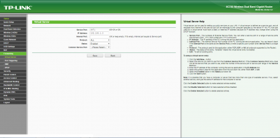

Seems like a forwarding issue, can you send a screenshot of your forwarding rule(s)?
BR,
Erwin

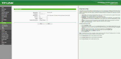

#37
192.168.1.3 is the HomeLynk with 1.1.0
#38
Leave internal port empty. Otherwise you are forwarding KNX to web server port.
#39
(28.08.2018, 18:15)admin Wrote: Leave internal port empty. Otherwise you are forwarding KNX to web server port.
I have done but the problem remains
#40
Can you check under NAT if the service is enabled (both current NAT and current hardware NAT status)
