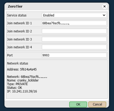

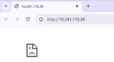

We have a problem that the newly set up zerotier connections are not working. Everything seems to be fine, the devices are visible on both LM5 and the zerotier interface, but LM5 does not respond to the IP address given by zerotier. Do you know of any changes that zerotier has made? The previous connections are working fine.
Thank You!

Yes, my computer IP address in that network is 10.241.127.25
(Yesterday, 08:28)Zoli Wrote:
(Yesterday, 08:18)Daniel Wrote: Did you connect to Zerotier from your PC?
I think the problem is with me. I probably had too many connections and that's why I couldn't connect to the new ones. Now that I've started to log out of older networks, the newer ones are starting to work, which they weren't before.
