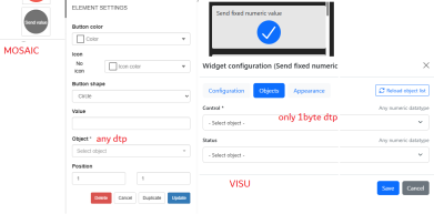

using the "send fixed numeric value" widget even though the control accepts "any numeric value" does not allow the use of a one-bit dtp

No as you can achieve exactly the same with a switch widget

You cant sent: 2,3,4,5... to a boolean object
