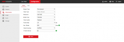

NFor show hik camera on webpage you must set one of its streams to MJPEG.
Then you can use such address (for second stream):
http://login:password@192.168.1.1/ISAPI/...02/picture

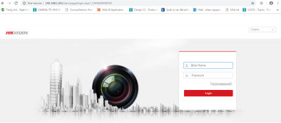

Check if you can open the stream url in browser. LM just tell browser what to open.

Check if you can disable authentication for stream in your camera. Specifying login/password directly in image URL has been deprecated in browsers for security reasons.

And check if fps is not to frequent for MJPEG. You can also check what is the path for image which is visible on main camera page when you change to MJPEG view or sub-stream view (it would have another ending /httppreview but more is about if this is appropriate channel etc.).
Done is better than perfect

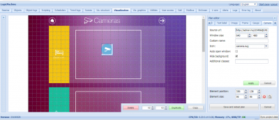

You have a camera with modern API which is described in the manual of API. Only things which are important for achieve your goal are:
- which channel is MJPEG,
- credentials.
It must work.
No this blue part but please click with right mouse button on image and copy its address. Then you can paste it here.

(05.12.2018, 05:15)Triet Phan Wrote: Hello.
this below URL works but it only show picture at that moment. That is not a stream
http://192.168.1.201/ISAPI/Streaming/cha...02/picture
do u guys have any idea ?
But you should set some interval E.g. 3s.

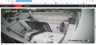

It is not question if LM support it or not. You are displaying it in browser and you should ask if your browser support RSTP. The answer is no
Posts: 5011
Threads: 28
229
You will need to use some external converter, LM on its own cannot do it.

Posts: 8162
Threads: 43
472
LM cannot be used for this. You need a separate hardware solution to act a proxy to convert camera RTSP stream to a format that browsers understand. Keep in mind that such solution can only be used locally, but not over LM cloud.
