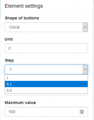

Hi. I see from an earlier thread that Daniel answered yes about adding 0,5°C adjusting possibilities to widget builder in 3.0. Is this still to be implemented before release of final Mosaic version 3.0?
(09.12.2018, 22:37)Kai-Roger Wrote: Hi. I see from an earlier thread that Daniel answered yes about adding 0,5°C adjusting possibilities to widget builder in 3.0. Is this still to be implemented before release of final Mosaic version 3.0?
(10.12.2018, 09:12)Kai-Roger Wrote: Hi Daniel. Maybe i misunderstand. In the picture i have a value changer with + and -. I can't adjust it by 0,5. Can i do it somewhere else?
10.12.2018, 09:28 (This post was last modified: 10.12.2018, 09:34 by Kai-Roger.)
Sorry Daniel. Did not se that (:

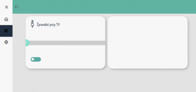

Another thing I've found that error (on fullscreen, in view mode):
This bug appears on Chrome, not on Firefox.
Did you try latest version? I think it was fixed.
Yes, I am using 20181214.
I was able to recreate it in previous version but not anymore, can you explain how to recreate?
I have a simple dimmer which on Chrome v71.0.3578.98 64-bit (up-to-date). It appears also in Editor, in fullscreen and smaller windows. I see this now also on Firefox. I have very simple project, only for testing from time to time what is the current Mosaic status
