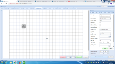

Hi there,
I would like to customize the visu of 1 bit object (0 = Auto ; 1 = manual). But in Touch Visualisation (smartphone) I can choose visualisation in checkbox or toggle.
I would like show and manage manual or auto written.
What do you suggest please?

Thank you Daniel,
only to be sure.
The modify about JS is done in additional classes field of the icon of 32/1/1.
Instead modify of CSS is done is Custom CSS of vis.graphic tab. Is it?
If so it does not work.

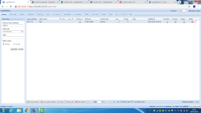

JS is under Scripting ->Tools -> Custom Java Script

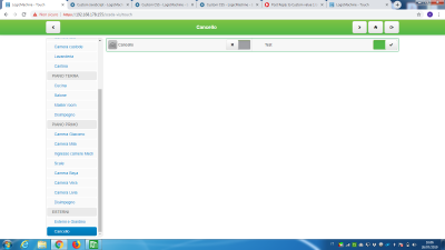

To see any result you have to open end visualization not editor and Add additional class 'custom' to the button on visu

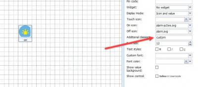

Additional class 'custom' is missing
Posts: 5254
Threads: 29
235
In the Visu editor

Note that this will only work in Touch visualization, not in the editor.

ooooooooooooook!! Thanks.
Everything is clear now. Custom is the name given to the btn.
Now I have created different name so I can link the any object I want.
I thank you very much for your support.
