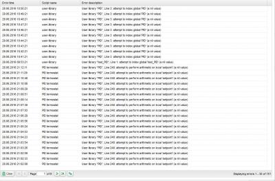

I changed only the value for line 5, inverted=true. I still got the valuea output=0 (you can see in the picture attached).
