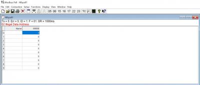

07.10.2022, 12:55
A new version of the modbus slave script where you can freely define coil/registers and even use bigger data-types and multiple slaves.
Data-types supported:
[ dt.bool ] = 1,
[ dt.bit4 ] = 1,
[ dt.int8 ] = 1,
[ dt.uint8 ] = 1,
[ dt.int16 ] = 1,
[ dt.uint16 ] = 1,
[ dt.float16 ] = 1,
[ dt.int32 ] = 2,
[ dt.uint32 ] = 2,
[ dt.float32 ] = 2,
[ dt.int64 ] = 4,
The number next to DPT is representing how many registers will be used per object. It means if int64 is used make sure to leave gap for 4 registers in the mapping table.
Only 2023 firmware and newer is supported

This is slave script, it does not read anything. Your master is responsible for reading. In there you define how it reads. Nothing to do with LM.
