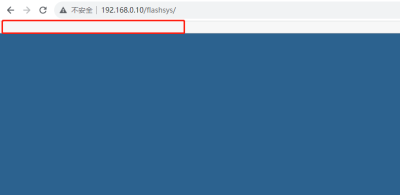

Admin, I have encountered two issues:
Q1:When an SP pushes music through "Qplay", it will be prompted "The device has not yet passed Qplay authentication, and some operations may not be able to function properly".
Q2:When another SP accesses the system configuration, the secondary interface that pops up does not contain any information, such as "System", "Network", etc.
Is there any way to solve these problems?

Posts: 7917
Threads: 42
Joined: Jun 2015
Reputation:
453
Looks like a corrupted SD card. It should be replaced/reflashed.
Posts: 92
Threads: 18
Joined: Apr 2022
Reputation:
0
I also attempted to restore it using this method, but it was not successful.
