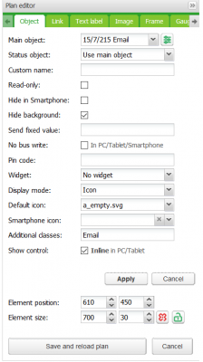

I have an object that is a 255 byte string and I would display it in line in the visualization. If I check Show control it returns an error.
I don't want that when the user have to write, he must click on the object that open the popup where to write.
Have you any idea how to do that?
Thanks!
Please someone have any idea how to do that? Huh
Because the popup is horrible, and the client don't like it Confused
What error do you get when enable show control?
This is the error:
Cannot enable Show control for this object
Possible reasons:
Read-only is enabled
Send fixed value is not empty
Widget is selected
Object datatype is either Time, Date or Color
Control type is set to Custom value select
My object is a 255 byte string, I attach the property:

Now I have only a problem, how can I change the width of this object, because when I change it via CSS it is overwritten by:
elemento {    width: 225px; }
that I don't be able to change it..
SOLVED: I put this code into javascript:
$(".Email > div > div > input").attr("style", "width: 700px;");
Big Grin
you can add !important to CSS rules you want to over-ride.
.customcls {     width: 225px !important; }
Faster way, thanks! Smile
