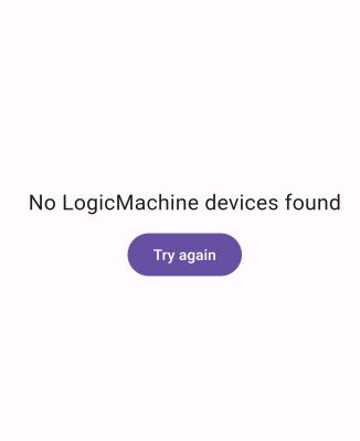

What can we do if we are in an enterprise network enviroment and the WiFi network is in a different subnet? I can access into my LM locally typing its IP in my webbrowser, but LM Home says "No LogicMachine devices found"
Posts: 8746
500
The initial scan is done via mDNS (multicast). Most likely the network setup blocks multicast between different subnets and so the scan fails.
