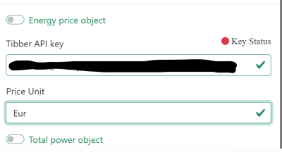

Hi, when i try it with my Tibber token it doenst work. What is the problem?
I have firmware 2024 04, maybe thats the problem
Hi davidkoch29
If you have received a message "You have entered correct API key." then key is accepted.
The Key Status icon is red it is our bug.
The prices are updated using your Tibber API key (once in hour).
Sorry about that.
Please remember that Tibber always gives you a value in NOK (Norwegian krone),
the "Price Unit" field it is only a text field for correct currency representation, user should write correct currency by himself,
it will not converts the currency from one type to another.
