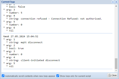

thank you sir it got connected but the data from the another side is not coming I am having an error
Posts: 8163
Threads: 43
473
"not authorized" error means wrong username and/or password.

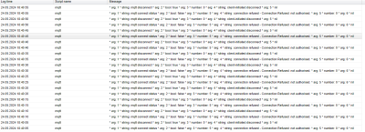

I have tried this code but it is showing some error
Posts: 8163
Threads: 43
473

After
mclient = require('mosquitto').new() (line 45) add this:
mclient:login_set('USERNAME', 'PASSWORD')
Replace USERNAME/PASSWORD with real username and password.

Shouldn't broker address be 'mqtt.intingy.com'?
Posts: 53
Threads: 9
Joined: Oct 2023
yes I have change it error are gone now And were will the data will be show I have to show the data into graph format could you please help me with that
