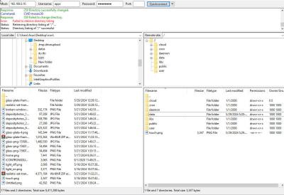

Thank you, I have uploaded two files via FTP, but where should the script be? event-resident-user libaries-commond functions or start-up?
Is there any requirement that the size of the picture

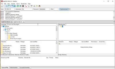

You need to use ftp login/username, not apps. Upload files directly to the root directory.
Posts: 8160
Threads: 43
472
You need to upload visualization.png and touch.png to the root directory of FTP (the one that is empty right now). Then run the script from the previous post.
