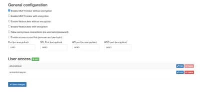

MQTT Broker has no points it is just a messenger between clients. The script you are sharing is MQTT client.

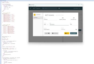

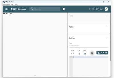

Post a screenshot of your broken configuration. In MQTT Explorer you need to use the same authentication data as in the script.
Topics won't be created until the mapped object is changed.

I am sharing 3 screenshots. Initial screen of MQTT Explorer, connected  screen of MQTT Exporer, MQTT Broker app screenshot.
Try changing object value and the topic will appear in MQTT Explorer.
If you want to keep last topic values for other clients then you need to enable retain flag for messages. To do this replace last line in publishvalue:
mclient:publish(topic, tostring(value))
With this:
mclient:publish(topic, tostring(value), 0, true)
Note that LM MQTT broker does not have any persistence. If the broker is restarted then retained topics are lost until new value is published.
