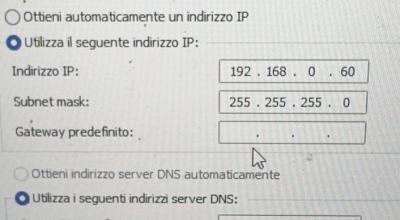

Post a screenshot of your PC network interface IP settings.

(21.04.2026, 12:29)admin Wrote: Post a screenshot of your PC network interface IP settings.
i have attached the screen shoot

no atachments

(21.04.2026, 12:51)Daniel Wrote: no atachments sorry

Did you perform the factory reset as described? Did the LED worked as in description? It is easy to press wrongly. If it still doesn't work then it is your PC network settings or cable.

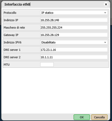

(24.04.2026, 06:39)admin Wrote: What is the LM local IP address? The route that you have posted does not look right. Router address should be an IP address that belongs to the same subnet as LM, but the destination network must be something different.
Alternatively you can add another local IP address:
Code: os.execute('ifconfig eth0:1 192.168.2.2 netmask 255.255.255.0 up')
Good morning, Daniel
I attach file for current net setting from naetwork staff.
I've now disabled LTE and zero-tier. The device works fine on the VPN and as a programming port. I can send SMS messages, but not emails. Could it be that the emails trying to go out are using the network with the parameters set and the network isn't enabled to send emails?
Now I'll try contacting the network technicians and see how I can resolve the issue. Otherwise, can you offer alternative solutions?
As always, thank you very much.

LM already belongs to the network that you were trying to add the route to. Route should be added to a network that resides on a different VLAN.
