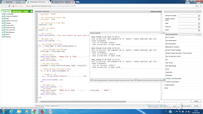

Consider that this error is shown when I launch the script but the file should be sent in the next 12 hours as per my setting. Or this error stop the script?

Like the script says:
--****************** DON'T CHANGE ANYTHING UNDER THIS LINE *****************--
But you changed this line:
trends_table = db:getall('Temperatura - Giorno') -- This is not a valid query
Set it back to original:
trends_table = db:getall('SELECT name FROM trends ORDER BY name DESC')
