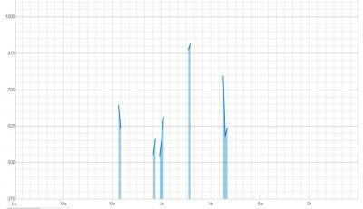

Hi, I have a mistake on a SpaceLYnk.
4 Power Tags on the SI D and 4 iEM3555 : data are concentrated in the SpaceLYnk but I have gap on the trends for the current phase. See an example on the attached file.
I have a problem for a lot of current phase from the Power Tags and from the iEM3555. The gap is not on the same hour.
I don't understand because for the Total Energy, it's ok all the data are seen on the trends.
Can you help me ?
Thanks !!
Clémentine
What trend type do you use? I think this trend is set to 'Counter', and you probably need 'Absolute value'
(22.12.2017, 09:08)Erwin van der Zwart Wrote: Hi,
Indeed, It's "Counter" that we use. I will change for one trend in "Absolute value" for the current phase.
Thanks a lot
Clémentine
