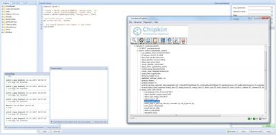

I have installed newest firmware and bacnet.ipk, enabled bacnet server and ticked export on two objects from knx.
The two objects shows in system config --> network --> bacnet obejcts.
For testing i wrote a resident script with 10s interval as seen in attached file.
Nothing in log, and it does not write value to virtual group adress.
Anyone see what I am missing?
Are you trying to read values from BACnet server on the same LM? This will not work. It's possible to run client or server on a different port but still you won't be able to read values by the client.
(24.11.2017, 10:47)admin Wrote: Are you trying to read values from BACnet server on the same LM? This will not work. It's possible to run client or server on a different port but still you won't be able to read values by the client.
Thanks. I got it working now, reading from another backnet server.
