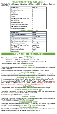

Maybe do you know how can I change these parameters:
Done is better than perfect
