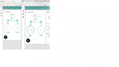

Hi i am having an issue with the Logic machine app using the remote connection.
Picture as attachment.
If i log into the app on my android it seems to log in correctly. All the mosaic visuals are there an values seem to be correct.
I  tried to change a setpoint and the value jumped back to the number that was original there. (Setpoint write and Actualt value is status)
I could not change the setpoint. I log into ETS because it was running alongside. I see the setpiont dont show in the diagnostic.
I then log into the mosaic directly on the logic machine i see that there is difference in the values that show in the mosaic on the app and on the mosaic on the logic machine itself.
Directly from the LM5 the set point can be changed without problem and the value is written to the diagnostic in LM5.
Anyone has any tip about what i may be doing wrong.?
Thanks for any help in advance..

I attached the json file for the widget. But keep  in mind the widget works fine locally on the logic machine but not using remote connection on the android app.
