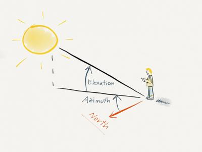

Hello
Do you have some algorithm to calculate a sun position?
How to calculate sun position?

Hi, while we’re on this topic.
Has anyone tried to work out an algorithm to calculate slate position of venetian blinds? Given the orientation of a window/blind, and the solar altitude and azimuth (given in post above). What is the optimal slate position to avoid direct sunlight? I’we been playing with some calculations. Even tried to “reverse engineer” observations from a major brand “KNX Wetterstation”, but never really got hold of it. Anyone with good experiences on this? Any suggestions on how to approach this is welcome. E.g. Is there one formula? Should i use a lookup table with different altitude- intervals for different azimuth “ranges”? Should i use a combination?
15.12.2015, 13:24
For starters, you can try with just using altitude since blinds only move on one axis. Blinds should be perpendicular to current sun position. Then you can tweak it by checking azimuth so you don't adjust blinds when there's no direct sunlight.
16.12.2015, 08:47
(15.12.2015, 13:24)admin Wrote: For starters, you can try with just using altitude since blinds only move on one axis. Blinds should be perpendicular to current sun position. Then you can tweak it by checking azimuth so you don't adjust blinds when there's no direct sunlight. Tanks, maybe i'm just making it too complex. There should, of course, be a 1:1 relation between sun altitude and slate position (e.g. 0-100%) – regardless of azimuth and orientation of the blinds/window.
