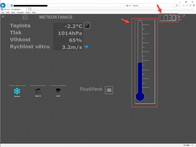

Do you know a trick how to get out these strange borders around any SVG object?
The only browser I've met this problem is an obsolete IE11 and actually dying Edge. But unfortunately I need to use it.

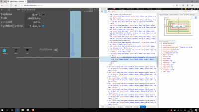

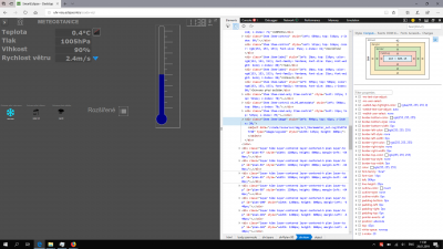

Try Right click > Inspect element and see if it has a border in Computed tab.
Posts: 408
Threads: 102
Joined: Oct 2016
9
I see nothing special here. I'm afraid there's something missing instead of wrong.

Simply wow
https://developer.microsoft.com/en-us/mi...s/7340561/
And the winning workaround is to use iframe (Frame in LM Visu Designer) and path to SVG picture instead of "picture".
