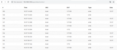

Here's a small sample app for monitoring using localbus.
localbus does not provide start/load events, but you can override start function before calling init like this:
var start = localbus.start;
localbus.start = function(auth) {
  console.log('started');
  start.call(localbus, auth);
.zip   monitor.zip (Size: 2.49 KB / Downloads: 30)

Hi admin,
I have tested your sample monitor apps and it works like a charm !
