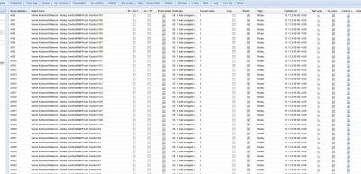

Is there a way for me to write for example a "3" to several objects in one script? Se attatchment.
Let say I tag all the objects I want to adress with "Modus", and I want to write this if another object (Lets say 32/0/3) is "True".

objs = grp.tag('my_tag')
objs:write(123)
Why won't it write the value of the group-adress 32/1/10 to tag "Modus"?
