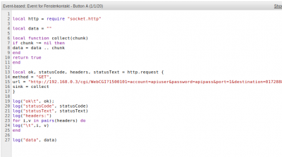

Try the code below and see what you get in the log. That's the response from your system. Please change the url to the correct url to make it work.
local http = require "socket.http"
local data = ""
local function collect(chunk)
if chunk ~= nil then
data = data .. chunk
return true
local ok, statusCode, headers, statusText = http.request {
method = "GET",
url = "http://192.168.5.176/cgi/WebCGI?1500101=...tent=Hello",
sink = collect
log("ok\t", ok);
log("statusCode", statusCode)
log("statusText", statusText)
log("headers:")
for i,v in pairs(headers) do
log("\t",i, v)
log("data", data)

i have tested the code.
But is still not working.
# This is a  trigger Message to a SMS Gateway, you can send SMS by WebCGI only with a simple SIM Card!
"Event for Fensterkontakt  - Button A (1/1/20) 14.01.2020 14:29:08
* arg: 1
  * string: data
* arg: 2
  * string: <HTML><HEAD><TITLE>400 Bad Request</TITLE></HEAD>
<BODY><H1>400 Bad Request</H1>
Your client has issued a malformed or illegal request.
</BODY></HTML>"
If you trigger by a Browser all is fine!
Any Idea what's wrong? "Bad Request"
