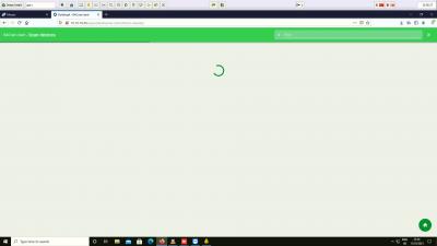

(11.06.2020, 13:19)Daniel. Wrote: https://dl.openrb.com/lm-19-imx6/pkg/gen...8_imx6.ipkDaniel Hi, I have installed the application from the store. I am using the specific Lmachine as a client (server is disabled) but during scanning, no BACnet devices were discovered. At the same network, there is a LMachine working as a server, 4 Siemens BACnet devices, and a BACnet Management Station. Is there something more to check in order for the plug-in to successfully discover BACnet devices?
30.11.2020, 07:17
Which firmware version and bacnet package (not genohm-scada-bacnet) version do you have?

Run WireShark with filter set to "udp.port==0xBAC0" and check if you have any Who-Has requests.
11.01.2021, 21:46
(11.01.2021, 08:52)admin Wrote: Run WireShark with filter set to "udp.port==0xBAC0" and check if you have any Who-Has requests. You can check at the attached screenshots that 10.10.10.35 asks with a who-is message and 10.10.10.36, 37, 11,12,13,14,19 returns an I am response . Nevertheless, at LM no device is appearing.
12.01.2021, 08:26
Try genohm-scada-bacnet instead of the BACnet client application. Remove the app then install the package from here: https://dl.openrb.com/lm-20-imx6/pkg/
